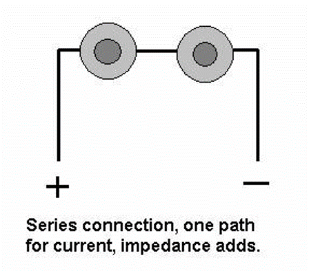

The first diagram shows two speakers connected in series. Assume that the positive lead from the power source connects to the left speaker's positive terminal, and that the lead connecting over to the speaker on the right also goes to that speaker's positive terminal. The right speaker's remaining terminal is negative and is connected to the negative terminal of the power amplifier. Because there is one path for current that passes through two impedances, the impedances add. Were these 8Ω speakers, the resulting total impedance would be 16Ω. As the higher impedance will reduce current flow for a given voltage, this represents a lighter load to the amplifier than the single speaker.

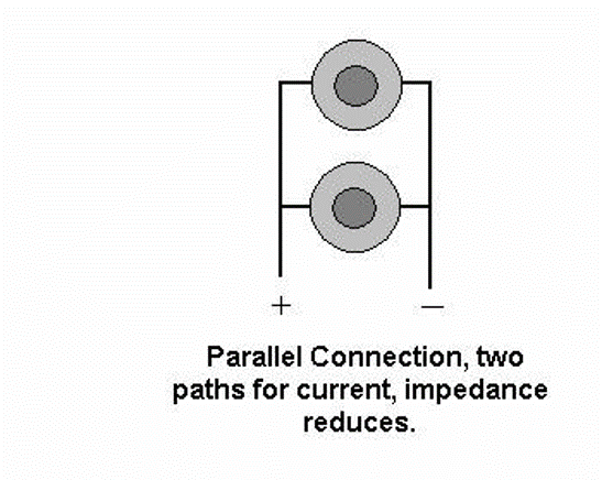

In the second example, the speakers are wired together in parallel; there are two paths for current to flow. If the speakers are the same impedance, then each will flow the same amount of current, for twice the total amount that the single speaker would otherwise flow (for a given voltage). Therefore, if each speaker is 8Ω, the overall circuit impedance is 4Ω. It should stand to reason that a single 4Ω speaker would flow the same amount of current.
