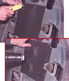

2. Cut and Heat
Using a sharp utility knife or heavy duty scissors, cut the SDS to the desired shapes and sizes of the corresponding panel areas to be treated. Remove the blue liner that covers the adhesive backed side of the SDS that is to be affixed to the panels. When applying large SDS sheets, it is recommended to only remove about 8 to 10 inches of the blue liner at a time and slowly work your way down the panel. It is also recommend that you warm the adhesive side of the sheet and panel using a heat gun. This will ensure maximum adhesion to the surface area, and allow the sheet to better conform to the surface. For maximum effectiveness apply heat to the SDS after it has been applied to the panel area.

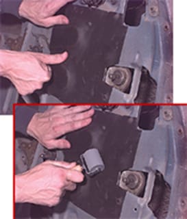

3. Press and Roll
While still warm, use a roller tool to work the SDS into crevices and irregularities and to smooth surface. Starting from one end, work out all of the trapped air between the SDS and panel that you can.
