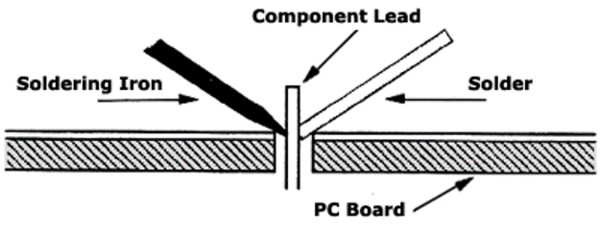

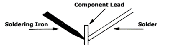

Allow your soldering iron enough time to reach full temperature, usually about 5 minutes. Start by heating one of the conductors to be soldered while holding solder in contact with it. Turning the soldering iron tip to maximize contact surface area will speed heat transfer. As the metal reaches the melting point of the solder, the solder will of course begin to melt into a bead or drop. Once the metal exceeds the melting temperature of the solder, it will "flow" onto the surface or "wick" into the strands of wire. If it continues to stand like a bead of water, the metal is not yet hot enough for a good connection.
Once the solder has begun to flow, bring the other part to be soldered into contact with the melted solder and iron tip. The melted solder will transfer heat quickly as it contacts the surface of the metal. Continue to apply heat until the solder flows onto the second part and takes on a shiny appearance. Remove the solder and iron. As the heat sinks away through the metal, wire, etc., the solder will solidify quickly making a sound connection. If any portion of the solder joint appears beaded or standing on top of the metal, reheat until it flows properly.
