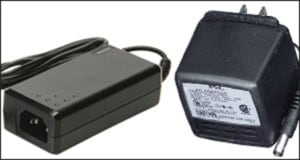

Regulated AC/DC power adapters keep voltage and current potential constant. Failure to use them can damage some devices. On the other hand, using a regulated AC/DC power adapter will never hurt a device designed for an unregulated AC/DC adapter. "Brick" adapters that operate inline with the power cord are more often regulated than "wall wart" adapters that plug directly into the wall, but this is far from an absolute rule. If you have doubts about which type of adapter your device requires, contact the manufacturer.
"Brick" and "wall wart" power adapters
